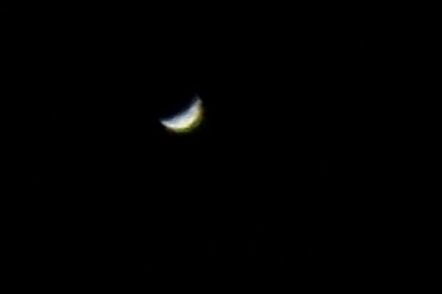

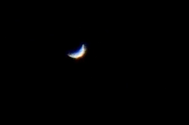

Now on to an old acquaintance of several members here from a very different occasion. It has been shining so bright in the south-western sky lately, it has even seemed brighter than the moon, so I had to have another meeting with it tonight although atmospheric conditions were not the best as can be seen from the variability in these frames:
NIKON 1 AW1, f/8 @ 420 mm, 1/500, ISO 160
NIKON 1 AW1, f/8 @ 420 mm, 1/640, ISO 160
NIKON 1 AW1, f/8 @ 420 mm, 1/640, ISO 160 (all 3 frames scaled up 2x)

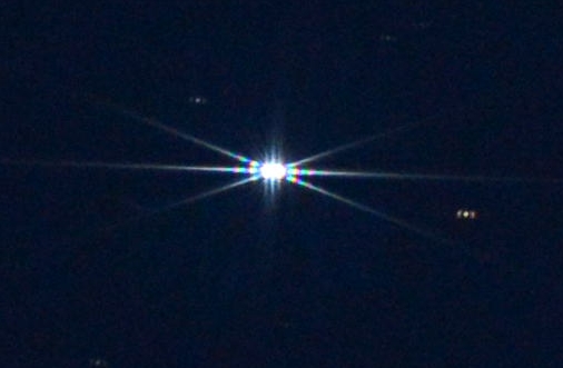

Focusing was very easy with my Bahtinov mask on the lens, showing marked diffraction spikes. The EXIF confirms that this object is brighter than the moon. Only the last exposure did not show any blown channels before adjustment. The surprising thing is that the near maximum brightness as seen here does not occur when light is reflected from the full surface as with our moon, but at a glancing angle.
Perhaps someone here with an even longer lens and a more quiet sky can get a better view of Venus?

Øivind
Wow, it is wonderful to see the planet being shaded by earth
A couple of nights ago I was out shooting orion again, while the images were taken, a friend and I were wondering what would it take to shoot venus as it was  the brightest object on the night sky, we figured a very long lens, and your images just confirm this , even 420mm on the Aw1 at 2x scale is not enough

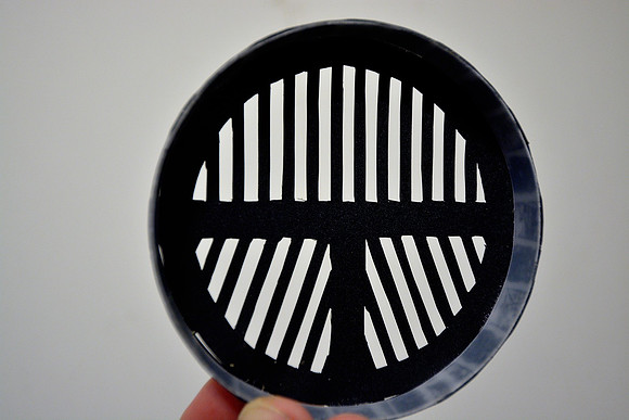

I did try creating my own bathinov mask and did not get great results , I ended up focusing in live view
Thanks for sharing your images

« Reply #130 on: February 23, 2017, 11:21:30 »
Thanks Amando and Akira for the the kind comments.
Actually earth cannot cast a shade on Venus if that is what you mean as it is always closer to the sun.  8)  The shape is rather caused by some degree of backlighting, just as with crescent moon. On Venus that seems to be reflected more than when light is reflected back at a 90° angle, opposed what is the case with the moon. I was surprised reading about this recently.

I almost always use live view/image review at 100% view to focus with the Bahtinov mask. However except on the very brightest stars and planets, it is necessary to take an exposure (typically 10 sec) and evaluate the result. So it functions more like a focus confirmation tool most of the time than one used dynamically. What I can see is the stars becoming narrower in 100% view near correct focus when moving the focus ring. But sometimes it is just as easy without the mask attached to use the faintest visible stars in live view as focus targets, and then confirm focus with a Bahtinov mask exposure. If possible I also use it at the end of a series to see if focused changed. It might happen if I do not let the lens equilibrate long enough to outside temperatures.
My homemade Bahtinov mask:
Near perfect focus (heavy crop):

I have never seen a  Bahtinov mask before, fascinatingly simple focus aid!
Seems to be spelled: Bahtinov

Oops, sometimes ones fingers are thinking out of order. Corrected where needed, at least I got it right once.  :D
