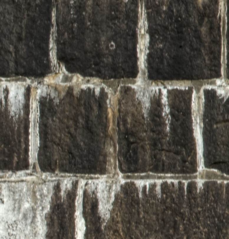

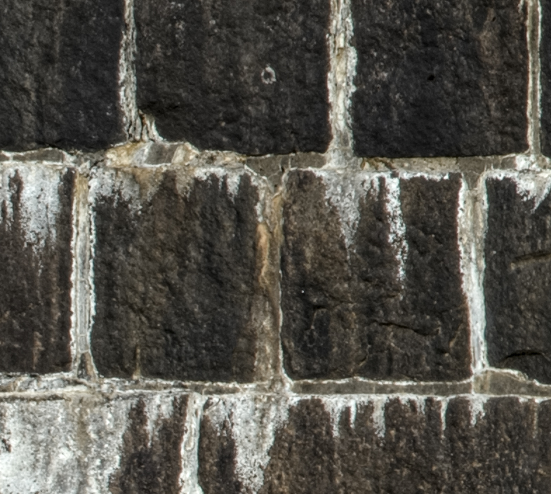

To see the influence of VR. here are two 100% crops of the tailrace walls of a nearby run-of-river power plant. Distance to subject about 250 m. The beefiest Sachtler ENG 2 CF HD and the Video 20 fluid head supplied massive support.
800/5.6 + 1.25X, f/22, 1/3 sec, D4.
Without VR
In my book, this is nowhere the sharpness one has the right to expect from such an expensive optical tool.
Now, let's see how VR might influence the capture.
With VR
The difference is pretty obvious.

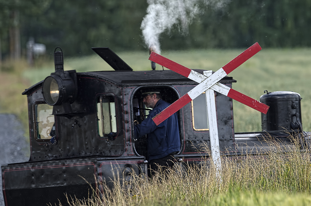

Another example to show the really shallow depth of field provided by the 800 FL E Nikkor.
A veteran (age 110 years) steam locomotive on a local narrow-gauge  railway captured at a distance of about 100 m. D4,  f/8, 1/400 sec, tripod VR off (this is the only sharp image from that sequence).
This is a 100% crop. Focus is on the crossing signpost and the locomotive is about 2 m further behind, yet at f/8 it is clearly  out of focus. The driver is quite blurred. Please view large.
To sum up then, the new 800 is a very selective tool for your optical arsenal. Is it worth the steep price? Only the photographer seeking a solution to a long-lens situation can answer that. Most of these lenses probably will end up being rented through rental companies. I can use myself as an example. Although I could affords this lens, I will not lay down this amount of money on an  item used a handful of times per year. I can always get a loaner for those occasions when the 800 FL E is the imminent answer.
