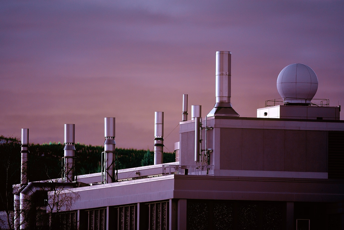

For the maximum versatility for IR captures, nothing can beat good zoom lenses.
Two of the better alternatives are the 28-300 mm f/3.5-5.6 Nikkor AFS and the 200-400 mm f/4 Zoom-Nikkor ED AIS. The latter is scarce and tends to be expensive, but if you can locate a specimen and afford its purchase, really is an amazing lens well worth the price.
I use the 200-400 mainly for landscapes and often as "false-colour emulated Infrared Ektachrome", but it does equally well with other IR expressions. This zoom lens uses rear filtration by means of gel filters (39mm size).
First is 28-300 (D5300 IR), next 200-400 (D600 broad-spectrum). The same mountain range doubles as test subject, but vantage points differ.
