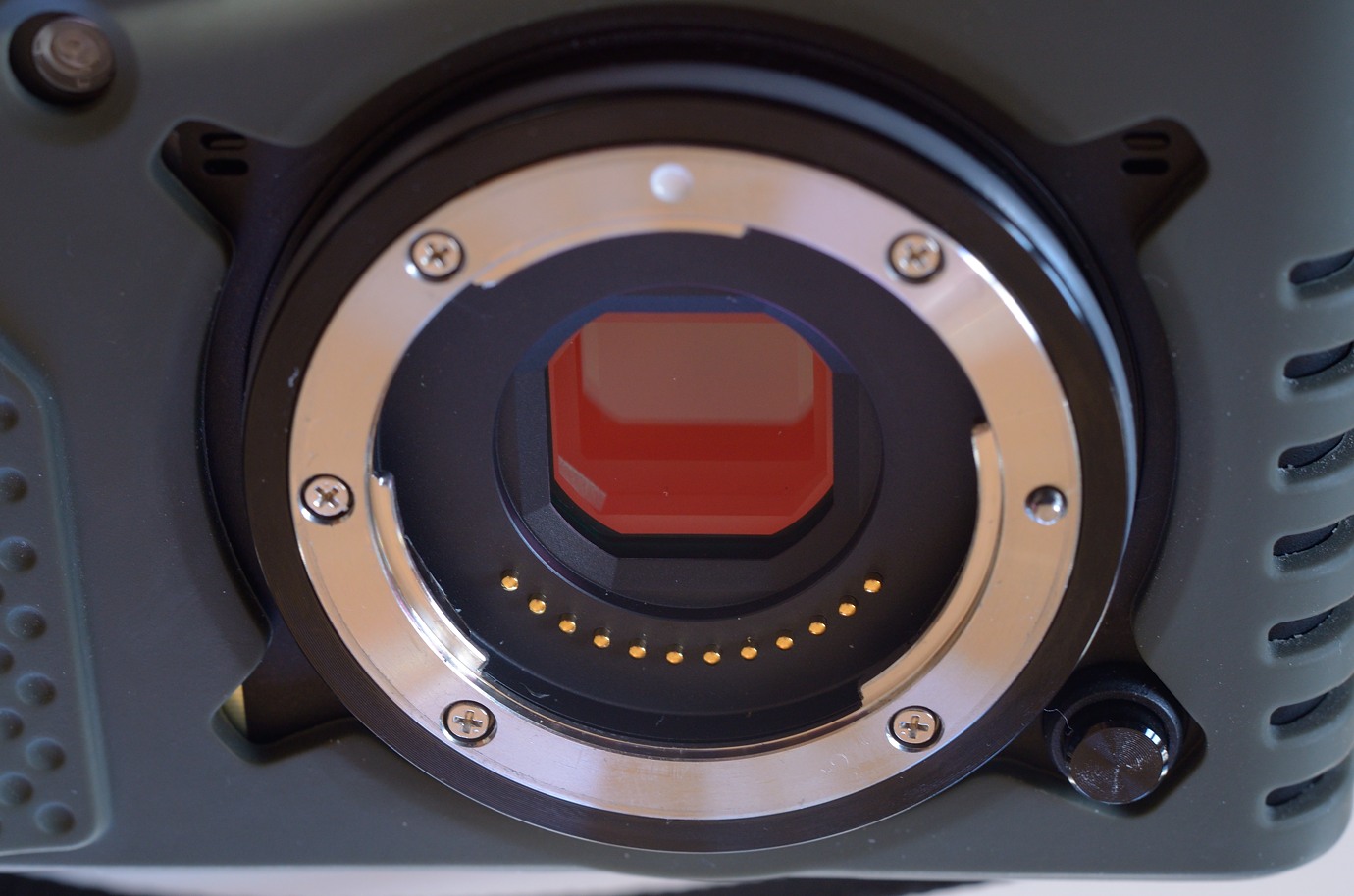

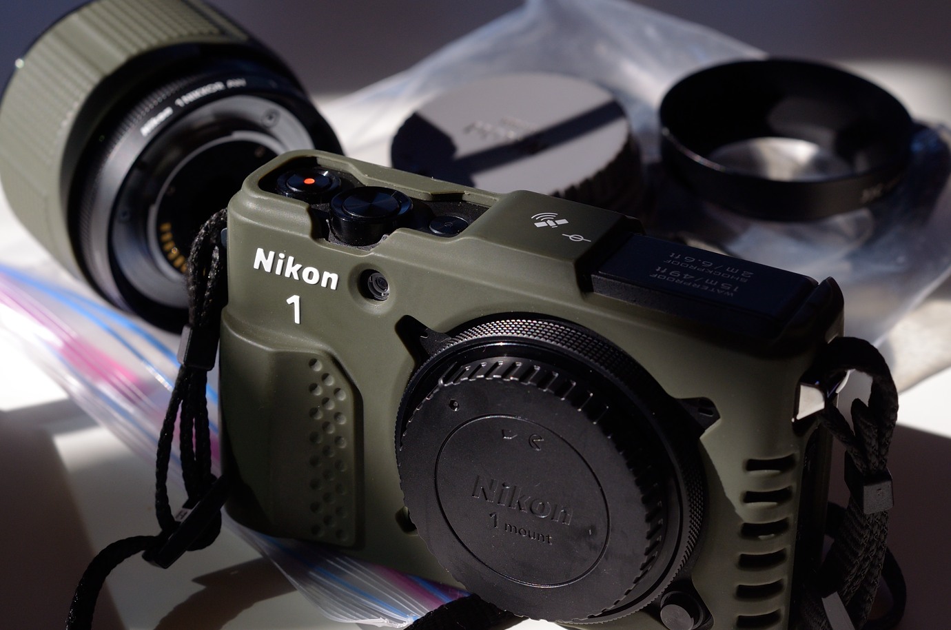

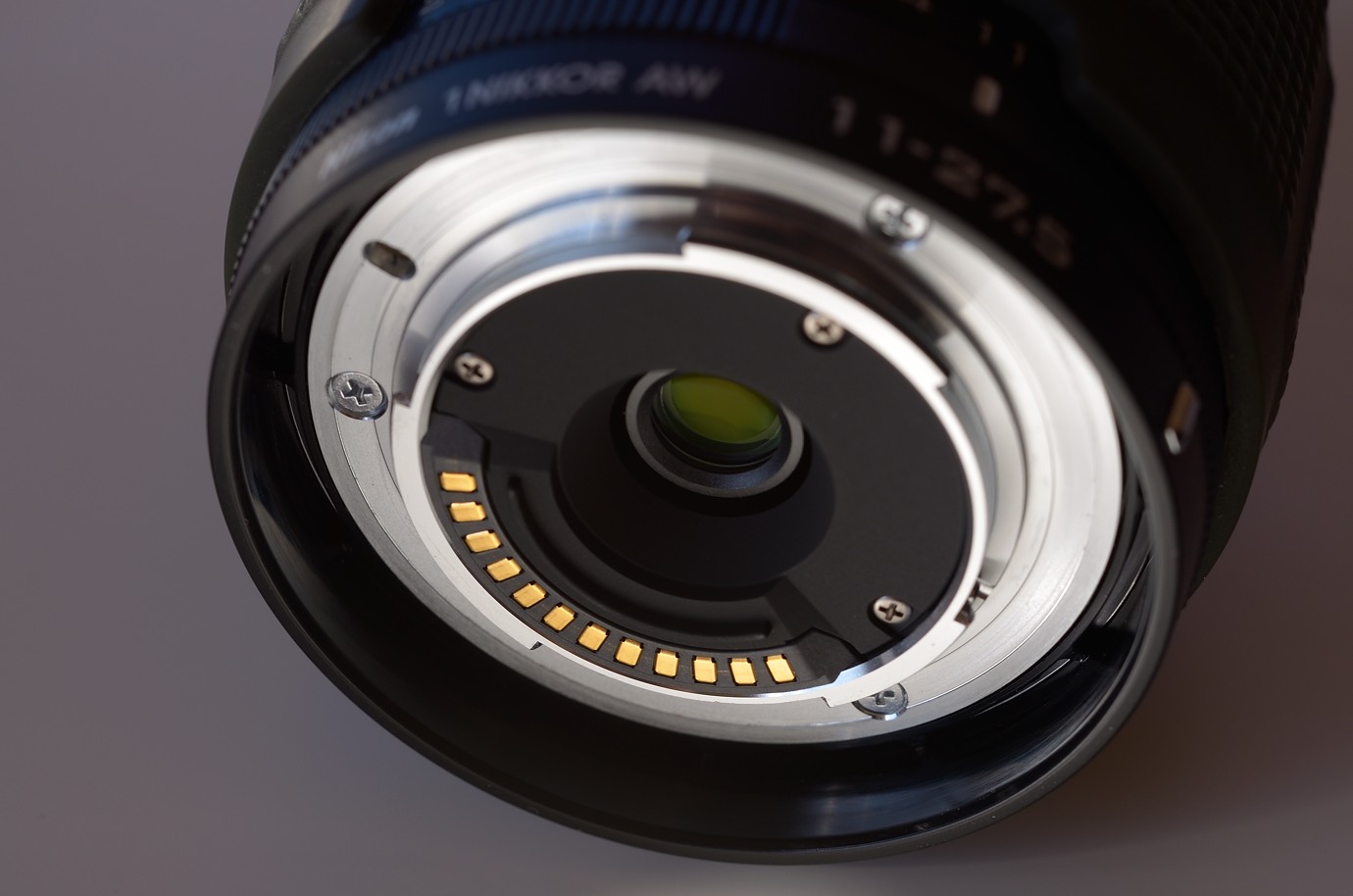

The lens is attached with the somewhat unusual external o-ring on the body, which simplifies user maintenance of o-rings to only one and also makes the design of the lenses simpler. It is pretty tight to get the AW-1 lenses off so this should be a patent seal if maintained properly and the O-ring is of high enough quality (I had to have Nikon replace the one came mounted on the AW1 due to irregularities in the seam of the o-ring). When the FT-1 adapter is mounted, a dedicated o-ring protector is used.
The sensor shield would normally be completely exposed when maintaining this o-ring. I bought a body cap for a regular Nikon 1 camera for protection during this procedure as o-ring maintenance should not be done in a hurry!

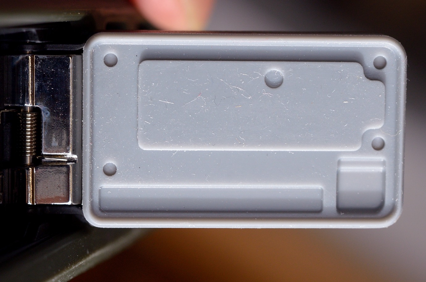

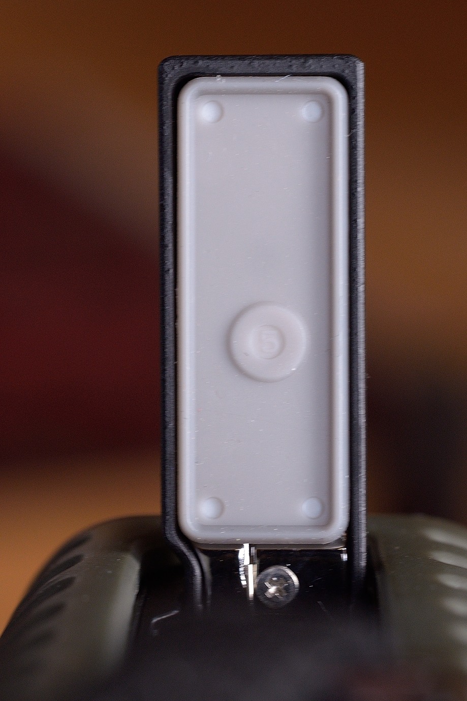

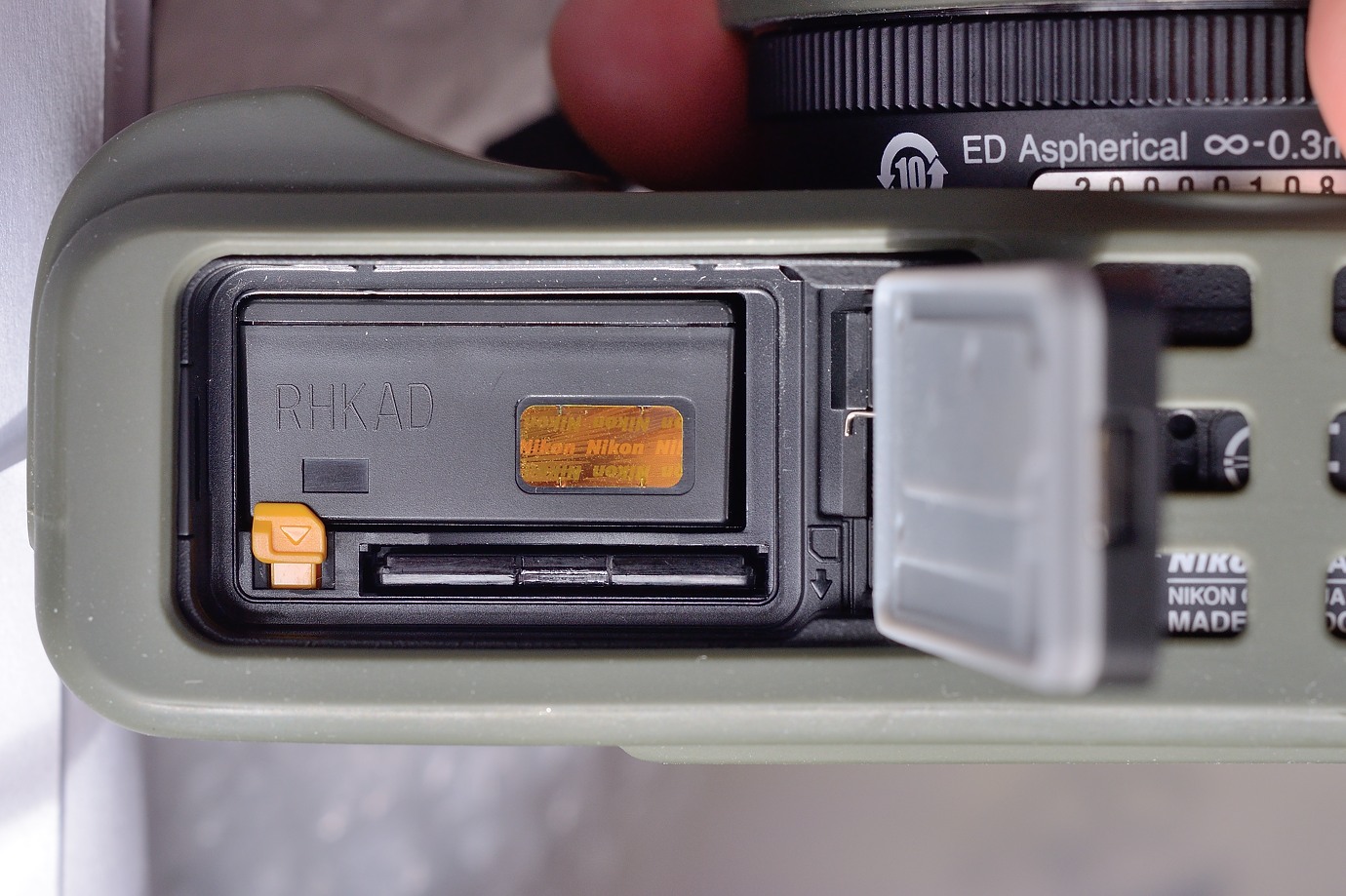

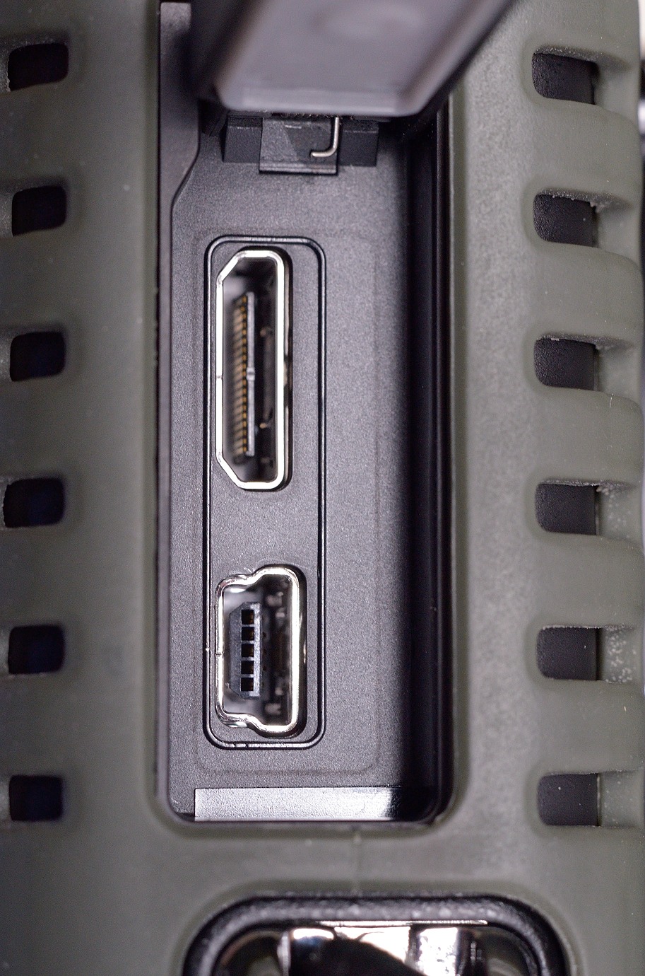

The ports over the battery compartment and connector port has an unusual looking gasket type seal. A common misunderstanding I have seen in various forums is to use silicone grease to maintain these gasket seals. There is nothing in the manual about using the supplied silicone grease on anything but the o-ring at the mount. There it is used to ensure that the o-ring can move freely in the grove, not to actually cause a seal. If grease is applied to the gaskets it could possibly function to "help" water pressure to push the sealing lip in, as there is nothing holding against it, particularly on the port seal.  We do not want that. The gasket is somewhat sticky which helps to keep it in place, but also adheres dust and small hairs. This stickiness transfers to the sealing surface too, which now and then need a bit more cleaning than can be done with a blower, so careful inspection of the narrow gasket lip and sealing surfaces is imperative. (I prefer to do so with a pair of strong reading glasses).
If it had been up to me I would have dropped the ports for the connectors altogether, and compensated by installing the missing ir-remote receiver in the little window for the focus assist light.

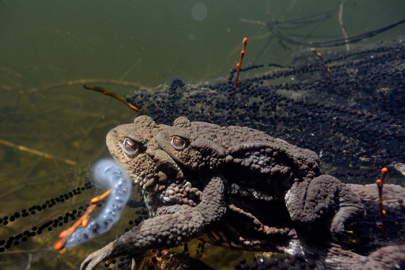

As mating season was on, common toads (Bubo bufo) were willing subjects, in fact it was often a problem that single male toads attacked the lens. The combination focuses almost to the surface of the lens, but auto focus often had problems to follow quickly enough at this short range. I soon learnt to shoot at 5 frames per second to increase odds of successful frames without motion blur in these murky waters.
Subawider +15mm f/5.6 1/40s ISO400
Subawider +15mm f/5.6 1/15s ISO 400

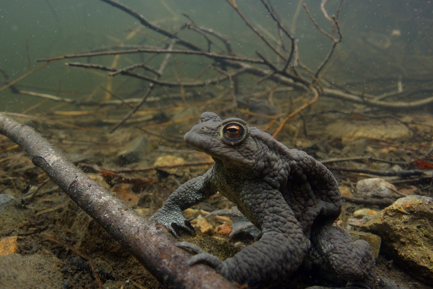

In another pond "Salamanderdammen" ("The newt pond") nearby I encountered a single Smooth Newt (Lissotriton vulgaris) that was cooperative just long enough to get this capture. This one is tiny, perhaps only 5-7 cm. Not often one see images of these in their natural habitat, but this one got blurry in this dark spot with very low reflective material on the bottom. Watch the shutter speed!
Subawider + 15mm f/5.6  0.4s ISO 400

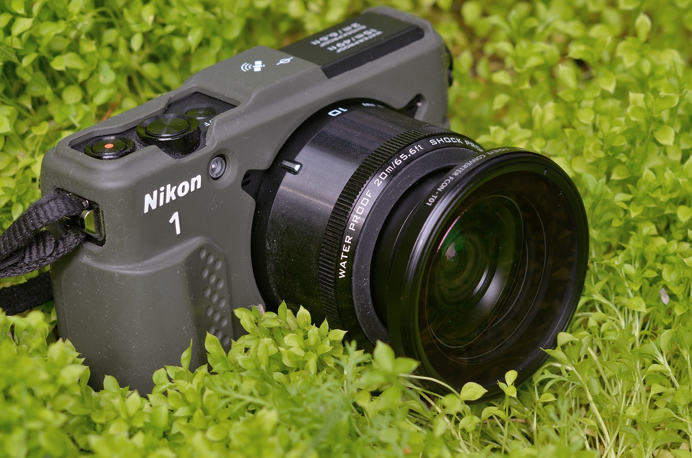

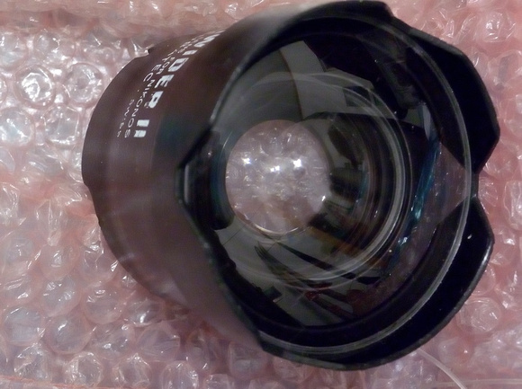

Sadly my Subawider II wideangle converter lens has some bad scratches on its front dome from hard use that shows up in some UW images, particularly with backlight. Also the AW1 kit lens started to develop wobble of the front and was due for warranty repair. I got some general concerns for the integrity of the dynamic type of o-ring seals at the zoom ring (they are about 1/2 as thick as the main seal judged from two samples that Nikon sent me by error to replace the main seal) This all spurred me into looking for alternatives.
In a dpreview post I found a reference to a page where the AW10mm f/2.8 lens was successfully used with an Olympus waterproof fisheye converter, The FCON-T01
http://www.nikonians.org/forums/dcboard.php?az=show_topic&forum=419&topic_id=3551&mesg_id=3551

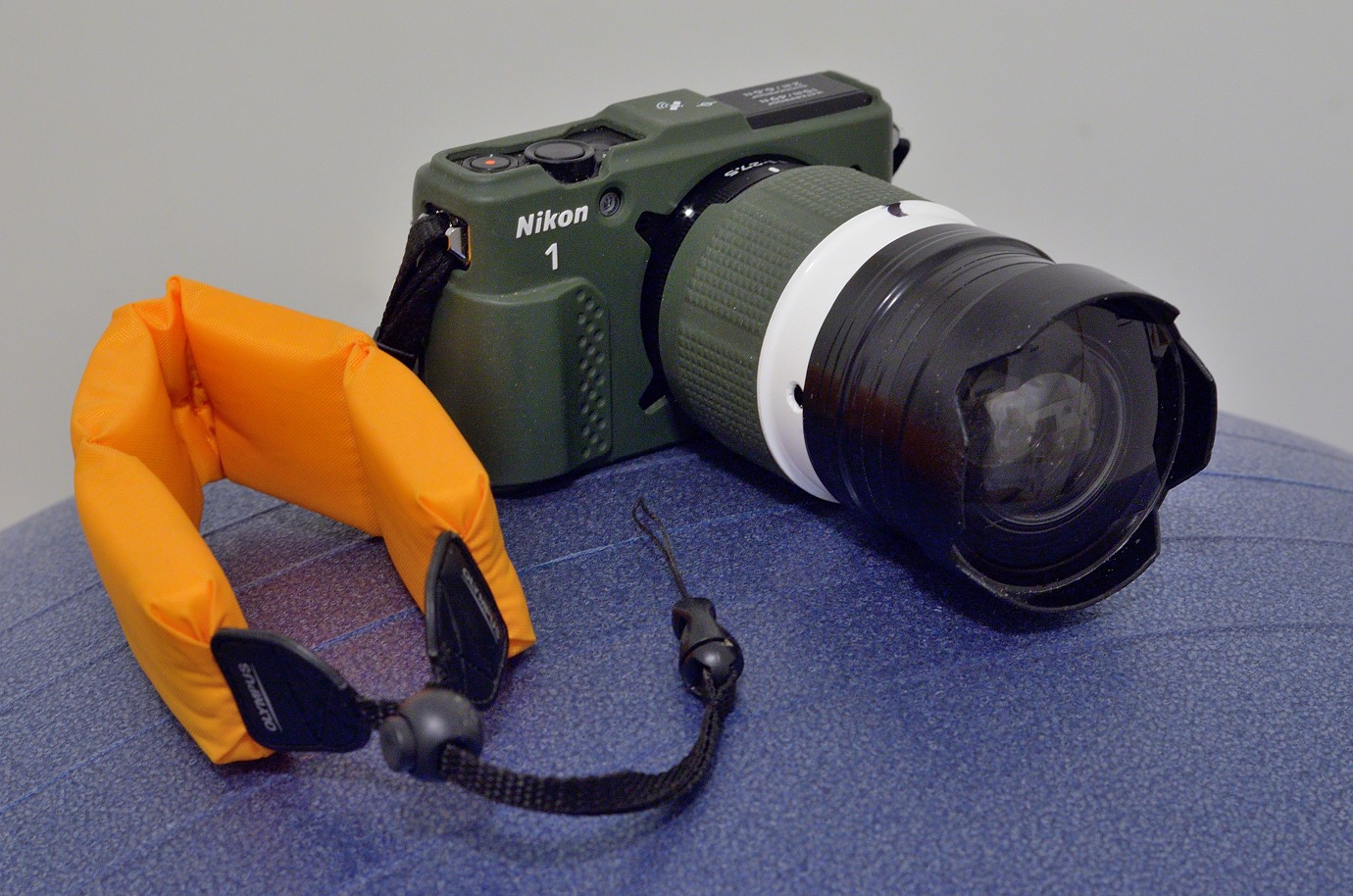

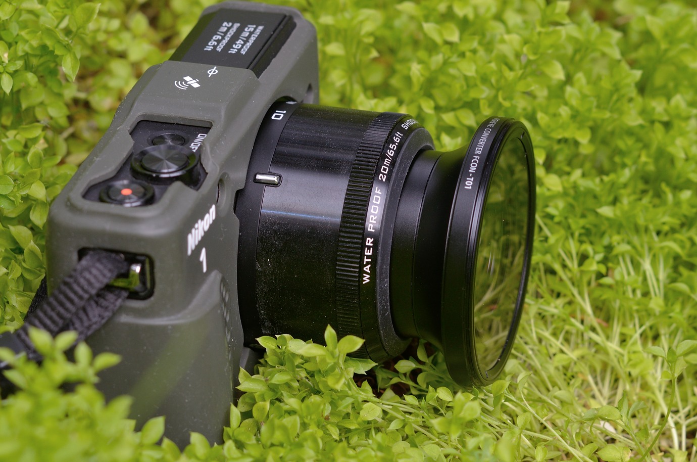

This $139 wideangle/fisheye converter has a 40.5mm thread and fits the AW 10mm lens perfectly without any adapter. (In comparison the NC filter Nikon provides for the kit lens is ca. $70). The last turn has more resistance perhaps indicating that it seals against the inside of the front rubber bumper. My own tests and reports I have seen so far indicates that the space between is kept dry. The adapter that comes with it for its intended purpose with the Olympus Tough TG-x series of waterproof compact cameras looks rather flimsy compared to the solid metal build of the converter. The optical glass looks to have a good coating and does not introduce much flare and ghosting in backlight.
At some point I discussed with Bjørn whether Nikon will release an underwater version of the 6.7-13mm lens. The problem we noticed is that a lens with a dome port corrected for underwater use would not work well above water and a flat port would not work well underwater due to the steep angle in the air-glass-water transition with a superwide. But is the latter true? The Olympus wideangle/fisheye converter has a flat front, but the inner glass surface of the front element is curved. Likely this adapter use the principles of a Rebikoff - Ivanoff panoramic correction lens, with a corresponding positve flat faced lens at the rear, http://www.seafriends.org.nz/phgraph/film.htm , scroll all the way down the page. The advantage with the design is that it will work both above and below water. The space between lens and the Rebikoff corrector can be both wet and dry. Here is a screen shot, but I recommend looking at the original page that also contains information about flat ports and dome ports.

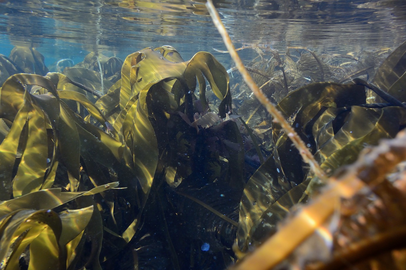

The Olympus waterproof fisheye converter works well with backlight, here at close range:
Olympus Fisheye converter + AW 10mm at f/4  1/320s ISO 160
Bridge over Chena River in Fairbanks. The above water performance of the combination is quite above expectations. There is some CA at the edges, but most of it is removed well in CNX2. If desired the distortion can be almost completely corrected vertically with Fisheye Hemi 3 (for 16mm fisheye on DX sensor).
Olympus fisheye converter + AW 10mm f/4 1/2500s ISO 160

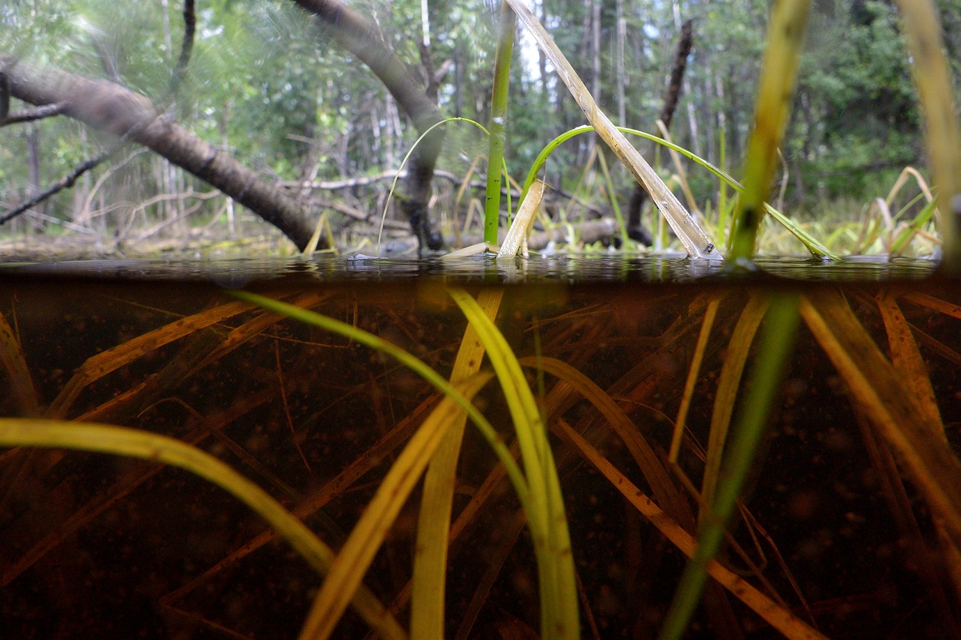

Over-under-images can work well with a fairly marked air-water transition but water quality in this case was very poor and a thin oily film on the surface that stuck to the front element and messed up the above water part. The low tones in the below water part usually has to be pulled up in over/under captures like these.
Olympus fisheye converter + AW 10mm f/4 1/400s ISO 160

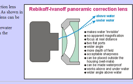

A Rebikoff corrector will have a narrower angle of view underwater and with an image appearing closer due to the differences in refractive index between water and glass. But remember that with the 10mm lens alone, this effect would be even stronger due to the air-glass-water interface. In a Rebikoff corrector the air-glass refraction is "canceled" due to the internal dome port effect where rays are perpendicular to the glass surface.

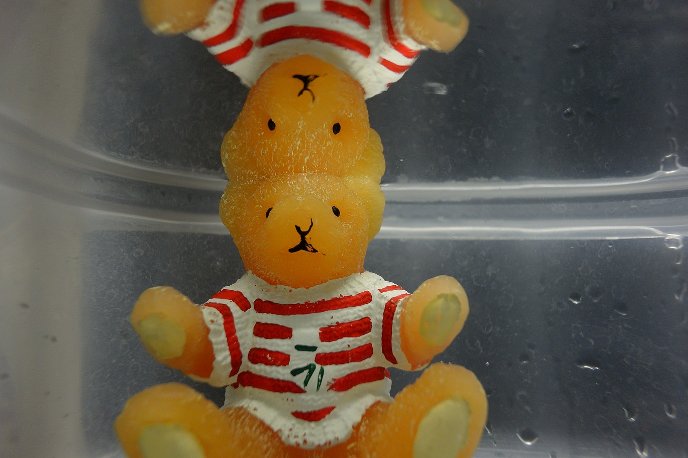

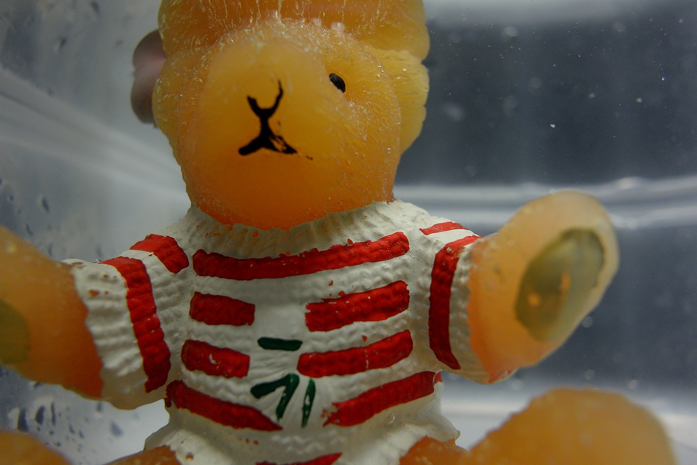

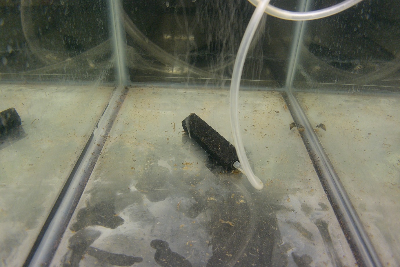

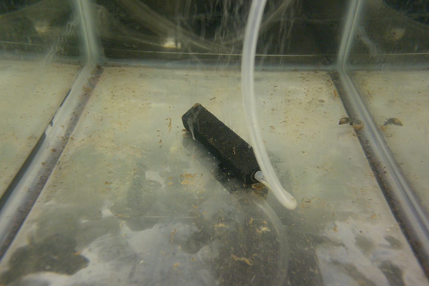

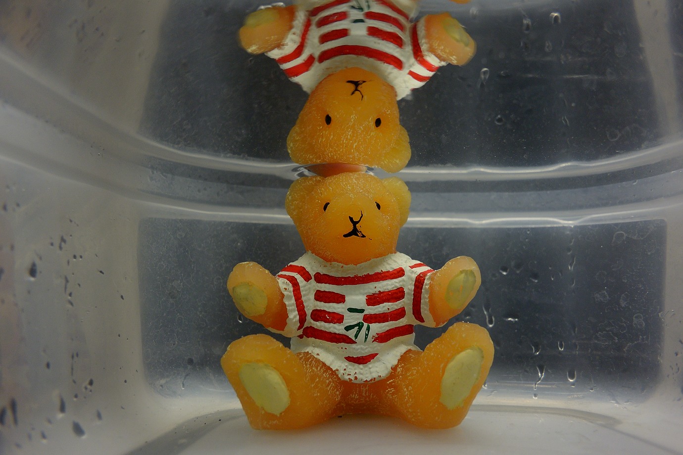

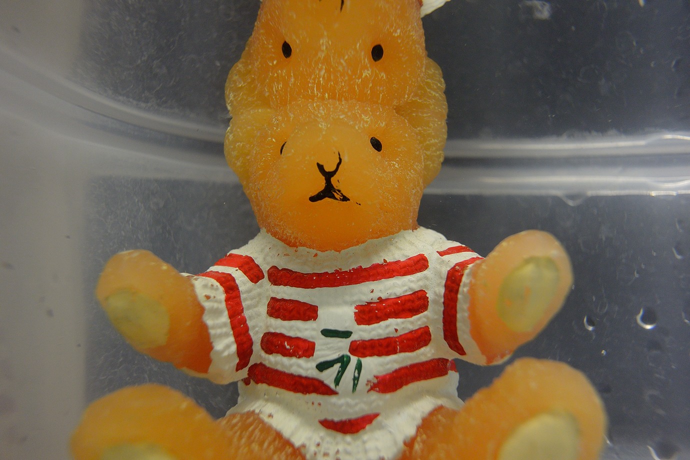

A resolution test in clear reverse-osmosis water. The red horizontal stripes on my poor wax bear's front is about 1" long. All of these captured at f/2.8 .
10mm
Fisheye converter+10mm combination
10mm closest focus
Converter+10mm combination close focus only a few cm from the front port. I can get nearly 2x the magnification of the 10mm alone. The correction lens apparently causes some focal range compression, as it does not introduce any near sightedness at infinity.
I did a brief test of the converter+AW 11-27.5mm in air for those that do not have the 10mm. I found that the zoom had to be set to 14mm to avoid darkening of the outer corners, which gives only slightly wider view than the 10mm. Thus I do not recommend the Olympus converter for the AW 11-27.5mm kit lens. Funds are then better spent on an AW 10mm f/2.8 lens.
I found remarkable performance of my 10mm in air towards infinity wide open. Optimum aperture is probably f/4 where the edges improve a little, but dead center is possibly best at f/2.8. Closer than ca. 30 cm the corner performance suffers and get very poor at the 20cm close limit (some field curvature and some lack of correction).  The in water performance reflects the good performance wide open, also with the converter, and it will be a big advantage to be able to shoot at f/2.8 to minimize motion blur.

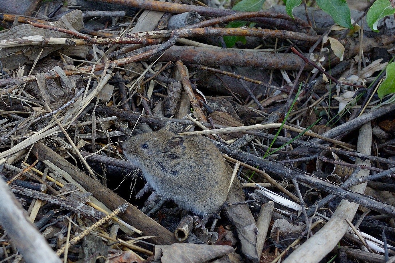

This vole at the Chena River beach obviously did not know that one are not supposed to shoot voles with underwater wideangle lenses.
AW 10mm f/4  1/125s ISO 160, crop to ca. 1/2 of the frame in each direction.

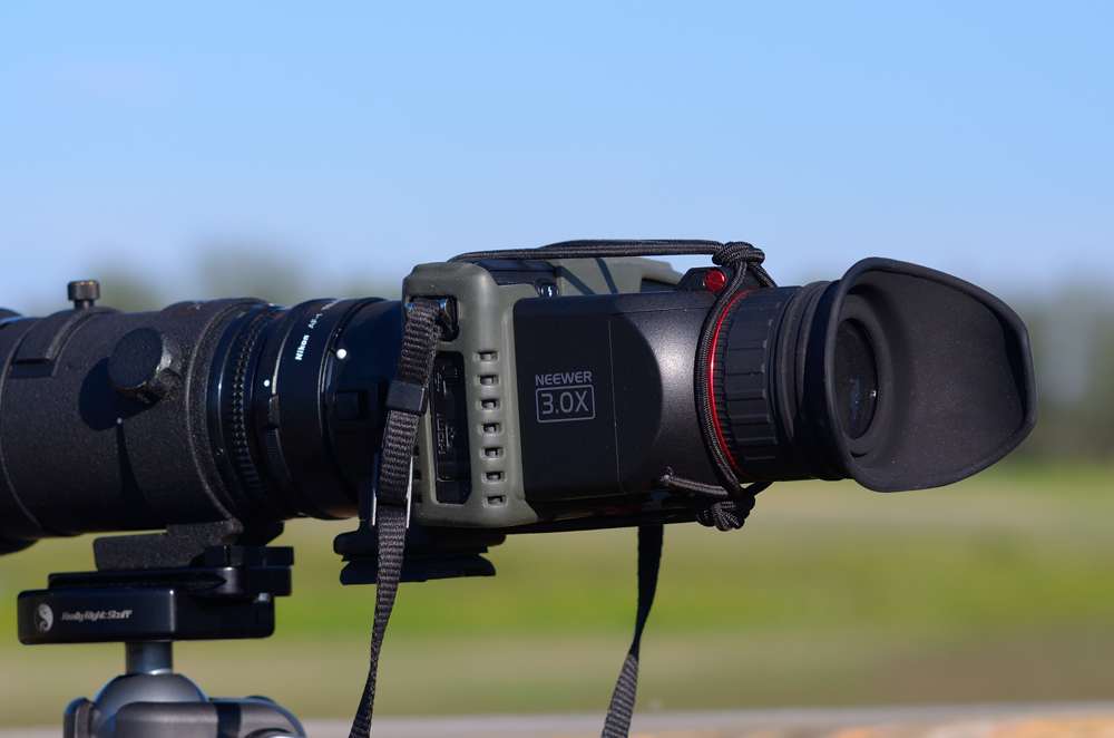

For underwater use I do not think that would be convenient. Optical finders for underwater use typically involve SLR action finders with a large window, or add-on optics that will allow the whole viewfinder image to be seen with a face mask.

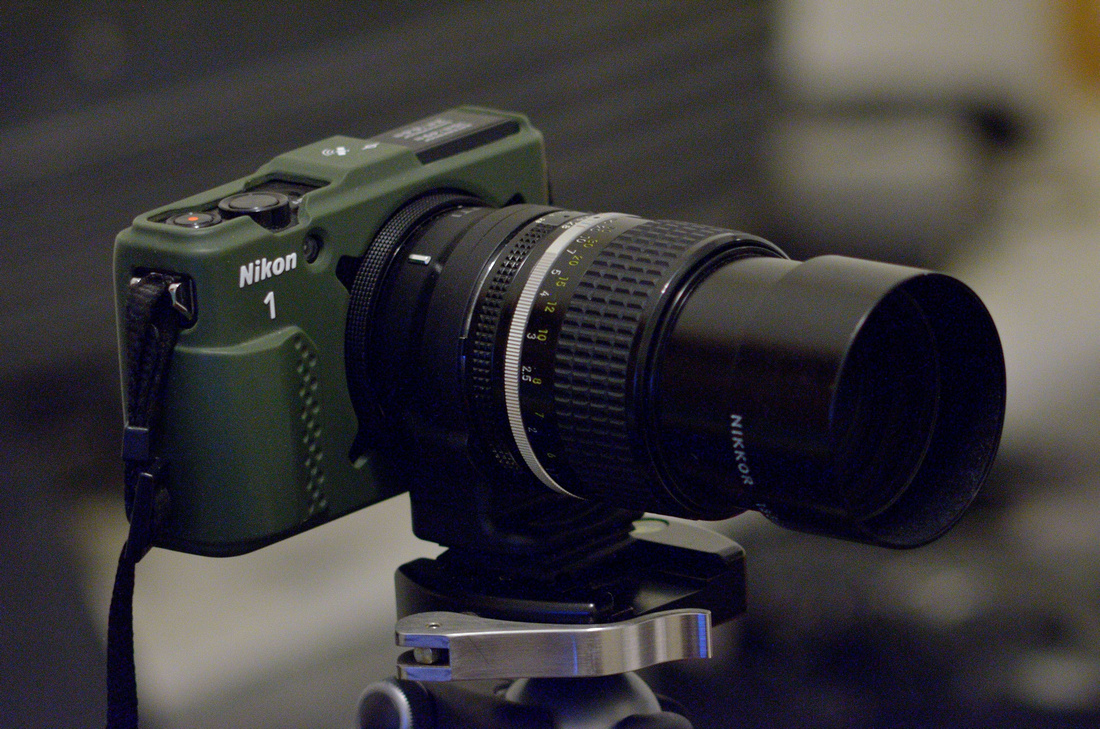

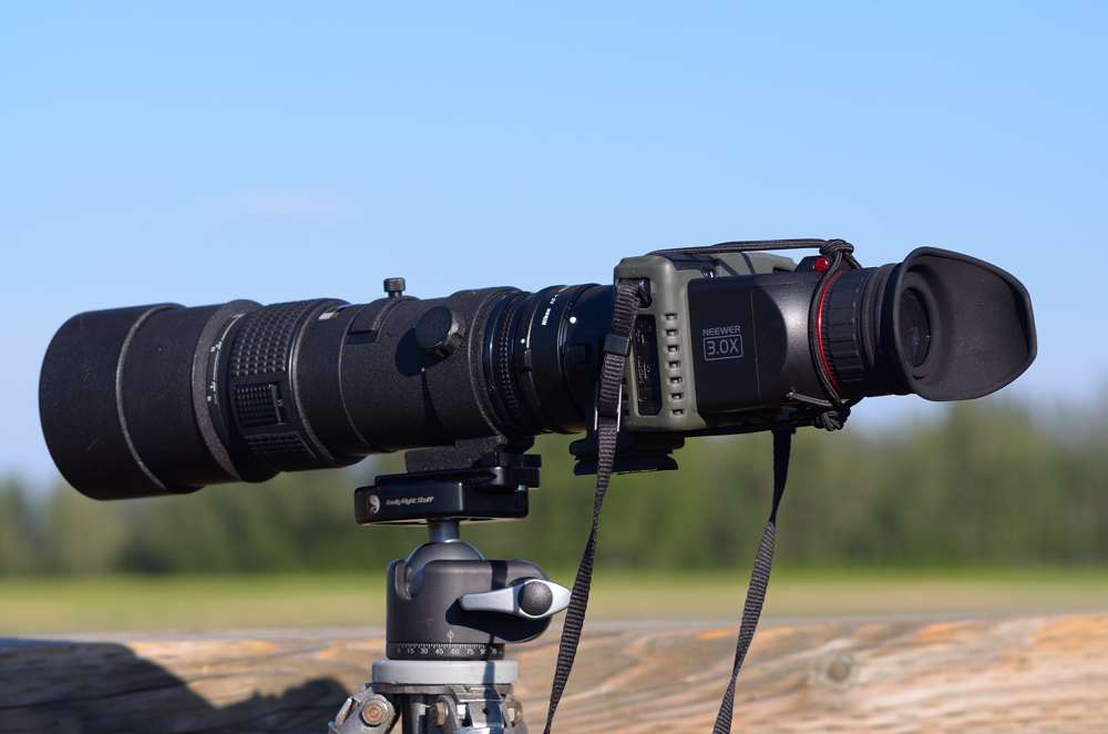

For land use, I got tempted to try out the following contraption, here mounted on my AW1 and AF 300mm. Not exactly compact! I would say that the optics of this 3x magnifier is excellent, although with some pincushion distortion. However the pixels on the AW1 screen get very large. It is nothing like looking though an optical viewfinder. (Elastic cord strap of own design).
Hard-core users do it without looking in the finder :D Done lot of toad and frog sex that way. Being attacked by the males is a real issue, since they misinterpret their own reflection within the lens to mean an adversary is on the prowl. You can literally be hit hard by the horny males. No joke at all. They swoop down on you like a missile.
I'm accustomed to shot 'blind' from my Nikonos days so the lack of a dedicated finder is no problem. Without an attached finder, the camera becomes much more robust anyway. Plus you can use the rear-panel display of course - however as duly noted by Øivind, your eye must be within a correct angle of incidence otherwise you observe nothing at all (cause by total internal reflection as a consequence of Snell's Law).
Thanks for the heads-up on the Olympus attachment. My own is ordered and on its way from Japan.
